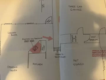

Here is a basic layout showing the new stove location and the stairs that go up to the bedrooms. The bedrooms are located above the art studio and the garage.
We have a ceiling fan in the living room and are running it on winter mode. I have tried running our furnace on "fan only" with little to no increase in heat upstairs. I have tried running a box fan at the top of the stairs pointing down the stairs with little to no effect. I can get the living room and dining area up to 75ish (probably more if I wanted/tried) and the kitchen and even art studio are pleasant, meanwhile the upstairs bedrooms are low-60's.

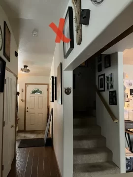

Could I possibly cut a vent in the wall where I have the pink arrow in the above floor plan? This would take hot air from the area near the top of the vaulted ceiling and let it pass directly into the stair way. Obviously, I'd be putting the vent between studs and avoiding any other framing. Here is a photo from the kitchen area looking towards the front door, proposed vent is where I have put the red X up near the ceiling. The red X isn't exact, the vent would be in the wall up near the peak of the vaulted ceiling.

I would likely make the vent so it could be opened and closed to allow more or less hot air up the stairs. Right now the temp upstairs is great at night but a little cool during the day and especially at shower time. Being able to open/close the vent seems ideal and I could likely make it reachable/adjustable from the landing on the stairs. Thoughts? Any other solutions that I haven't tried that are less invasive than cutting a hole through the wall? I've kicked this around in my head for a few days and I don't see why it wouldn't work well.

Here is a basic layout showing the new stove location and the stairs that go up to the bedrooms. The bedrooms are located above the art studio and the garage. View attachment 304962

Based on air flow in our 2-story home, it occurs to me that the box fan should go at the bottom of the stairs. If I sit on our 2nd floor landing, I feel nothing but air warmed by the living room stove. At the bottom of the stairs I can feel cool air near the floor. And as you probably know, slowest speed works best. I "heat" my office using a small desktop USB fan sitting on the floor in the doorway. Last night the living room was at 76 and my office, with door closed for dog control, had dropped to 63. Within an hour of that fan spinning it hit 68.

I think the fan where.you indicate would work. And contrary to what I generally think, having it pump warm air out of the stove room (i.e. flow pushed into the stairs) would likely work best indeed.
The problem you have is that the warm air has to turn too many corners for it to reach upstairs. Pushing it there will allow cold air to drop down the stairs.
The corollary is that the art studio will get somewhat cooler.

You mention possibly opening and closing the vent from the landing of the stairs. Is that landing located halfway up the stairs which then turn to continue all the way to the second floor? If that’s the case, have you tested putting a fan on low on the landing to blow cold air down? If you had one at the very top blowing toward the wall, I could see that not being so effective because too much air would bounce back.
I very much like your idea of cutting a hole, though I think I’d be in favor of using a small transom window instead of a vent if they make them small enough to go between studs.
@stoveliker had a good point, I thought, that in this situation a fan blowing the warm air to the desired location might be helpful. (I’m sure you’ve noticed in your recent reading that the common recommendation is to blow cold air toward the stove, and that’s why you tried the fan at the top of the stairs.) I know I’ve read of such a thing as a room-to-room wall transfer fan on this site. There’s also one (or used to be) that goes level to level and would allow you to take air from near to the ceiling downstairs and move it a bit higher up the wall upstairs. The fans are designed to go between studs. The manufacturer that I recall is Tjernlund, but there may be others. I have no personal experience with these, but I’ve read about them here.
Before I went such a route, though, I’d continue playing with fans to see if you can work something out. I’d also spend time with an infrared temperature gun figuring out where the hottest air is downstairs. I‘d also experiment with pushing the stove a little harder (you said you could get the temperature higher in the living room) and see if you can effectively move that heat more toward the base of the stairs. Have you put a fan opposite the door shown in the picture and blown cold air in that direction in order to move more heat down the hallway toward the stairs? That might, of course, obstruct the access to the kitchen. I’m just thinking that you could do more playing with moving air before committing to a hole in the wall. There’s also a little trick that I found helpful in studying air flow in my own home. You can tape or tack a few squares of bathroom tissue at the top of door frames to see the air move. You could also stand on your stairs and hold some squares of tissue down near the steps and see if air is flowing down (though you could also probably feel that on bare feet). There’s just a lot of investigating you could do, though all of it may still lead you back to the solution you asked about initially given the layout of the house. From the picture it does look as though you could be trapping a lot of hot air in the hallway up toward the ceiling.

One more thought I had: if you put a fan in where you indicated, and if the art studio gets too cold when the fan is blowing hot air (onto the landing), then you could always reverse the fan (or its installation). You'd then blow colder air down into the stove room which will be replaced by warmer air coming up the stairs. That increases the flow from the stove room to the art studio (rather than have the cold air bounce down from the stairs onto the art studio).

Open up the stairwell wall to the left looking @ the bottom of the stairs. IMHO.
