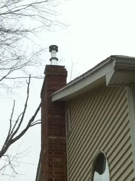

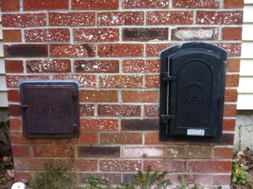

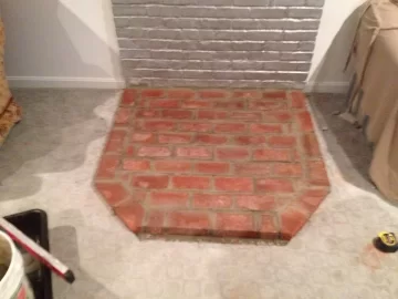

I started with the brick hearth. The previous owners had a freestanding propane stove on glass over the rug. My next step was to make the flue clean out bigger so I could fit the Selkirk 4VP-TD (double clean out) which will allow me to clean out the short horizontal run.
I then had to match up the Selkirk vent to the existing hole in the masonry, run a short horizontal run into the chimney, and then fit 23 feet of rigid Selkirk piping down the chimney which proved a bit challenging.

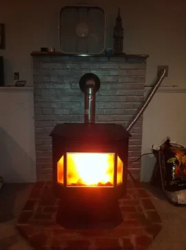

It heats great - we'll see how it is when the outside temperature is below freezing. This is a finished basement install, the only thing I don't like is the OAK but that is my only option unless I bore another hole into the second flue and use that as an OAK.

That Flame Looks HUGE! Is that at start up? With abundant fuel in the pot?
Beautiful install.
Yes that was on startup. It heats the finished 900sqft down stairs no problem and I have a fan to get some heat upstairs as well. This weekend I need to get two tons of pellets...
Very nice set up, enjoy
I agree w/ you about the placement of the OAK, but other than that, it looks great! Enjoy the heat!!

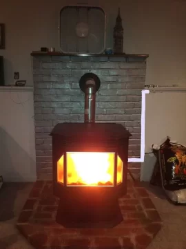

I fixed it,....

Gonna be brutally honest. Looks good, except the oak. But thats just my opinion.
Well given a choice of being able to use the new heated space or having it cold or even worse heating it with "dino juice" I'd be happy to have that OAK there and enjoy having the stove running (although it might interfere with hibernation if you are a bear).
Thanks everyone, I may eventually put a wood stove in place of it and move the pellet stove upstairs and tap into the second flue, or maybe I should save for a pellet boiler! I went to a local hardware store to purchase some rigid pipe for the OAK but the guage was too small according to the requirements in the manual. I faxed a local metal shop to see if they could customize some pipe for me but I haven't heard back. For now I am going to enjoy the heat.

The OAK is necessary for that stove. Although it doesn't look pretty the way you have it, it is functional.
As for the.other flue. If it is completely sealed off from other appliances, then I would think its possible to do.
Also. Putting the heat where you NEED it most ((where you spend your time amd need warm air))!! Basement installs arr tricky.
you can't use PVC pipe for an OAK. ;em It has to be heat resistant. It looks like PVC,anyway. Maybe not.
I THINK he just used Windows Paint program or PChop and "adjusted" it. Does look like PVC on my phone.
Once/if you get a different pipe for your OAK, you can try painting it the same color as the wall. Come out of the stove horizontally then vertically up along side the brick to the pass through.
maybe could of moved it closer to the brick ran it up right along side and make a fake brick cap to cover it ? does look great
opps thats what shaw did in his drawing lol

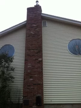

Unfortunately the brick on the inside does not match up with the outside. If I drill just to the right of the brick then I will hit the brick chimney on the outside.
It does look nice. I like all the glass that those style stoves have. Tweaking that OAK is easy. IMO, it's the fact you used flex pipe that's throwing it off a bit. Just need to square up the lines a bit. Or just leave it and enjoy the heat.
