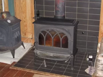

February nothing. We wanna see pics of that stove now.
Ok, a picture it is. The old stove is still sitting beside it, and the room isn't as tidy as I wish it would be for public viewing, but here's our new stove! (I'm attaching the image as an attachment since I don't know any other way - hopefully that works)
Cheers,
Chris
  • [Hearth.com] Another newbie looking for advice
I don't know but did that stove pass inspections?" I would never pass it on that existing connector pipe. That amount of rust shows metal fatigue
The clearance in front of the loading door appears to be less than 12".. I suspect the rear tile wall not sufficient for clearance issues
finally what about the r value of the tile the stove is sitting on
