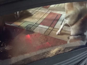

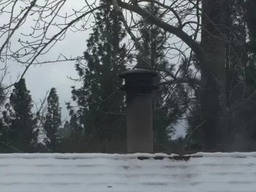

To verify you're getting a good clean burn, check the chimney, there should be little to no smoke once it's settled down. Here are some pics of my stove and chimney right now, cruising at 450 (sorry about the glare)

Hey, the glare did not bother me, but how the heck did you get your pup inside there...??
Chimney is fine, just had it cleaned and hardly anything but powder came out, and maybe a 1/4 cup. It has been crusing along fine with a small load and going for a lot longer than ever before. I really think my problem was that I thought I had to have flames showing.
