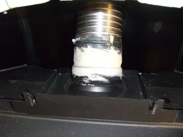

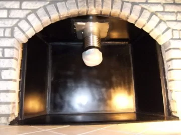

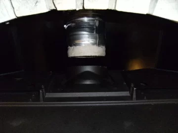

I did the same as your doing and went with the Flex King Pro liner.
I left a good length of liner out the top of the chimney and pushed the liner up high enough to slide the insert in, line things up and then let it down into the stove collar once I was sure I had everything lined up. Despite all my measuring I still ended up having to trim the collar on my damper block plate to allow the liner to bend enough to meet the collar at a good angle. I was lucky that the Clydesdale collar is adjustable and on a 30deg angle off the stove top, otherwise I would have had to either redo the collar on the block off plate or use an adapter. Turns out I was able to do a direct shot to get the best draft as my Chimney is on the short side approx16Ft.. Once the liner was in and selaed with high heat goop I cut the top to desired height and sealed the top plate as well. Hope it helps in your install. And please post some pics of your install, Would love to see them
A few pics for clarity sake..

Never planned to try to finish the liner before the stove arrived. But I feel I can pretty effectively tell where the liner will fall in relation to the front of the firebox. And whether it will work according to the dimensional drawings.If it needs to be moved more than the liner will flex or it comes in at too much of an angle I plan to order a 30 degree el. Biggest thing I am trying to come up with is suitable material to build the block off plate from. Went to the metal dealer we buy from and they had 18 gauge stainless 304 and up, too heavy to try to work by hand. I figured I might be able to use 24 gauge galvanized pan material, very readily available. I am a welder and a little uncomfortable about galvanized even though I don't believe it will ever get hot enough to be affected.
