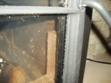

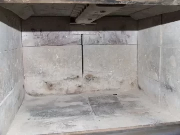

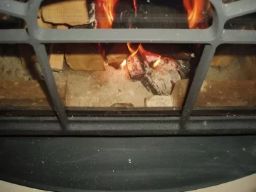

Ok, so it took almost 6 months to get back to this topic for me but hey, I was busy with the wood piles! Here are some pics taken during this time period when I had originally began this post. Hope you can see by what I mean with the bricks along the front edge and sides, along with the glass being dirty. As for the wood, it was very well seasoned oak - 4+ years as I had gotten it from a moving sale where they had it very well stacked and dry and we had it another 3 years before burning it.

Heatit your bricks do not look right. I think the 2 bricks in front should be the ones that go on back wall in between metal baffle. You should not have any gaps on back wall between top baffle fibers and bricks. The baffle fibers on top should be push as far back and I got a 1 inch gap at front of stove, no gap in back. I installed mine last fall but I think the brick in front were a different texture than the rest. Also I had to trim alittle off one of the cut bricks for it to fit, but just a hair. I take a pic if you want but try rearranging the bricks.

Chachdave, I agree and will be looking at that. I am thinking that ours are wrong. So in your unit the front bricks do not have the cut outs as ours do? If possible a pic of the front edge would be helpful.
I have an 1100c which has a different but similar set up. It looks to me like the bricks you have in front should be in the # 4 position as per the manual. My installer set mine up wrong also. Luckily I only burnt 3 small summertime fires before I realised his mistake. To his credit the manual isn't as clear as it could be.

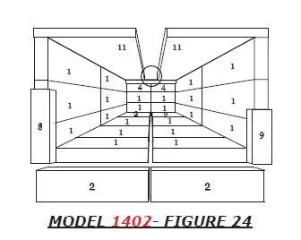

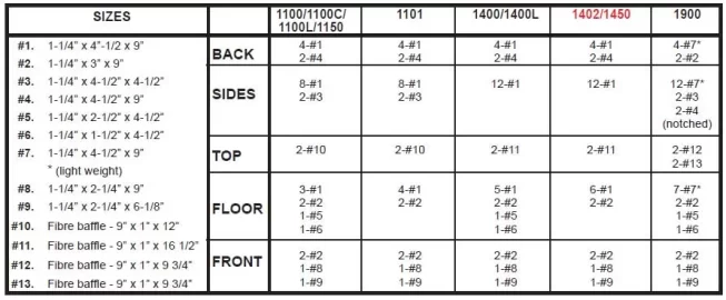

Here's a 1402 brick layout diagram:

Anyways, thanks for starting this topic. I had my brick installed incorrectly as well and just fixed them a few minutes ago. They bricks with the notch come from the factory in the front. I think this is why everyone gets confused, and since the manual does not show bricks with notches. I had notched bricks facing outward in the front with the odd sized bricks (8&9;) inside the notches. Now that they are at the top back, with the notches there to allow for the secondary air tube, I makes more sense now. Also, with the notched bricks in the front, they were too tall and that may account for the dirty glass people complain about.

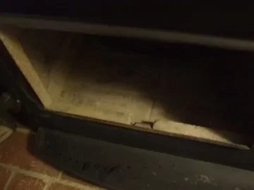

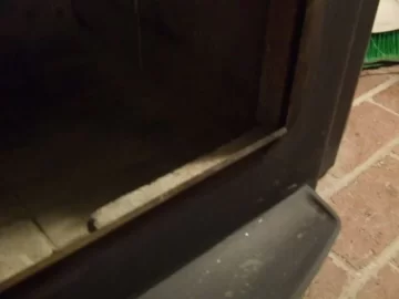

Here are the pics of my insert brick layout. The front bricks are below metal door opening. I think I also put them in wrong last fall, must be all that excitement of just getting it ready for first light up.

Heatit,
One thing that I noticed immediately is the absence of a coalbed. Before you load up the stove with logs, you should have a well established bed of coals that covers the bottom. Then lay the splits in there with the pointed edges pressed into the coalbed. You don't want flat sides laying on top of the coals and smothering them.
