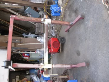

It would be great having one, wouldn't it? I'm looking forward to getting mine done. I'm at our Nevada place now, need to get back with the material . Was able to pick up a piece of square steel tubing, so together with the time, I'll be able to get something done.
The carriage is completed, I need to set the band wheels, I'm using pulleys with belts. I have a 18hp Koholer. I've been a bit indecisive with how I was would mount the wheels and arrange the adjustment, that held me back some.

The patent on the woodmiser must be expired by now. When I worked on the thing was in the mid '90s. Just google up the patent and do an exact copy. The wood miser used vee belt pulleys with loose belts too. Seemed to work real well.
Not sure why this pic is on it's side. viewed is the motor I plan to use.
Richard
