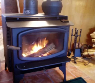

Our Avalon Rainier 90 is a wonderful choice (of course WE would think that) for functionality, EPA rating, and although less ornate than the one you are looking at, VERY capable of heating a good size dwelling. Made in Oregon (I'm an advocate for keeping our money in domestic production), and sturdy as all get out!
