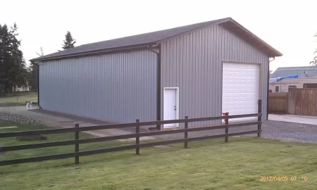

Thanks for the pictures Highbeam. I was going to ask if you can frame a service door of the corner post or not. I wasnt sure if you had to have X amount of space between the edge of the building and the door for trim or what not.
In my case, the posts were true 6x8 plus you have the outer girt at 1.5" plus the jack and king studs for 3" more. Left me over 12" between doorway and wall which was plenty to fit the corner trim and a sliver of siding.
Sorry for all the pics, you can ignore them if you'd like.
