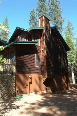

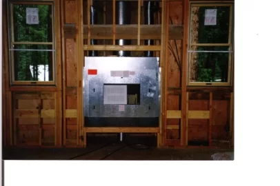

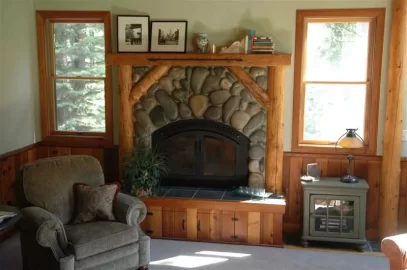

Thanks for your help on this. I've attached a few photos of the current setup.

Since I'll have the alcove down to the studs when I pull out the Extrordinair, I was wondering if there is some kind of noncombustible materials I could install to simulate an existing fireplace and go with an insert...

You pretty much have to rip the entire deal out and install another "built-in" stove and chimney - or, if the clearances allow, you can install a stove in the alcove, but that may be difficult size-wise....check the owners manuals and see the alcove size.
Yes, you could install a pre-fab regular fireplace in there and then install an insert into it (approved and listed insert for this app), but that might have some down sides also. For instance, ZC fireplace can sometimes "wick" in cold air when not in use.
If you do a lot of homework and buy a really well proven built-in unit with regular Class A chimney (not the fireplace-type pipe as the FPX used), then you might be on the right track. It looks like you are tight on room, and therefore that may be a good way to go.

How about not replacing the fireplace at all? Rip out the current unit/chimney pipe and install a full Class A up the chase. Then seal up the fireplace hole into the house with something appropriate. You can install a wood stove on the hearth (enlarging as needing) and either run the stovepipe back through the sealed up fireplace, or go up a bit and into the wall with a thimble. Either way exhausting up and out the class A chimney in the chase.

I'm looking at your pics again, especially the one with the rock firepalce shown. I think making that into an alcove and putting rock inside the alcove up to the same height would look awesome. Your house looks awesome by the way. I really think the alcove would look good in that room. In addition to the rock lining inside the alcove, you could put a mantle all the way around the alcove on top of the rock.
A third idea...similar to sealing up the fireplace openeing, seal it up and then run that rock all the way across and go up to the ceiling with it.
