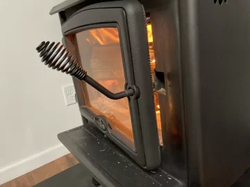

Anybody else have to leave your door open a bit to get a fire going?
Ignem
Feb 14, 2020
20
Kentucky, USA
Here’s what I often have to do to get a fire to catch without choking out:
[Hearth.com] Anybody else have to leave your door open a bit to get a fire going?
Anybody else have to do that?
Is it because I have too much draft?
Yes it is quite common. Many manufacturers even mention it in their instructions. And no to much draft would do the opposite
Common method often mentioned in stove manuals.

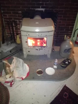

they're not that old! how is letting air flow through the grate to juice the fire significantly different from cracking open a side or front door?
and i can't see how i've been "lucky" since this stove has been used heavily every winter (october thru march) since winter '95/96, and i've used the ash door method as needed without abnormal damage.
i've done two break down rebuilds since new, with the prime issue the inner top breaking down (a known weak spot in this stove). replaced the grate once, the fireback twice, the baffle twice, inner top twice, damper twice. the inner right side is original, but do have a replacement.
all outer pieces are original, with typical porcelain damage (dutch west paint job a step down in quality from flagship stoves, but even those suffer porcelain damage over the years).

Opening the ash pan door is essentially making a forge out of the firebed. In a cold stove the sudden heating up of the grate area while the surrounding base area is still cold can cause cracks to radiate out from the grate area. This does not happen when the stove door is left open a little. That air goes crosswise across the firebox for a more uniform heating.
I have the Chevy version of that Osburn stove and my door looks much the same on initial startup.
