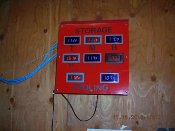

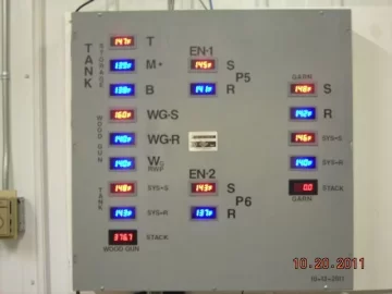

For monitoring only I've used DS18b20 digital temperature sensors to LED panel meters for temps less than 225F and K-type sensors to monitor flue temp to similar meters designed for K-type sensors. These have been in use for several years, about 35 in total on four different monitoring panels. I think only 1 or maybe 2 have failed, and during the heating season they are "on" 24/7. Power is from a walwart DC supply.
A benefit of using DS18b20 sensors is that they can be wired together to share the same cable, although I tend to use several cables anyway because of convenience due to location of the sensors.
Pix of two of the monitoring panels.

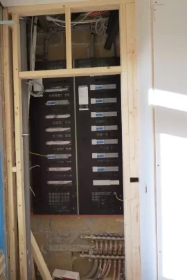

I eventually ended up with this:
Mine is a bit smarter - just as well given what it cost! Can only find photos during construction though ... I'll take new ones and upload later.
