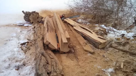

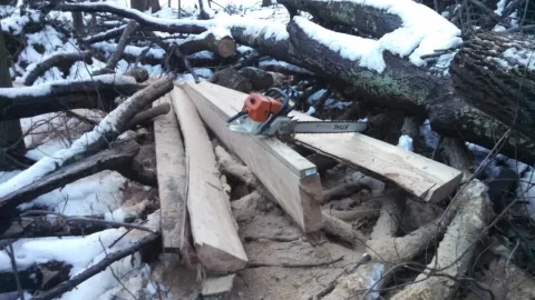

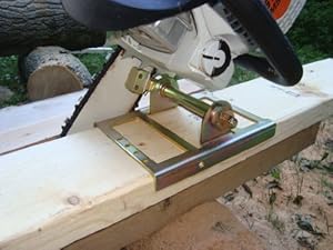

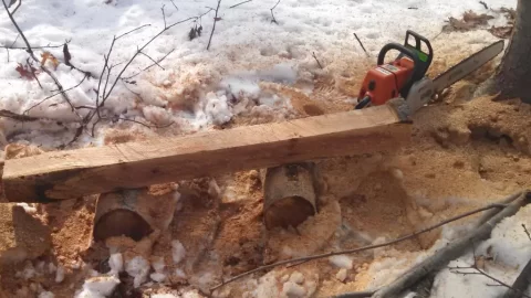

Bought the Haddon Lumbermaker for $90 shipped off Amazon, and today I took it out for a spin.
First I cut a 4x4 test beam from a oak limb using the 036/20" and a 4' 2x4 as a guide.
That went pretty well so next cut a real beam. Used the 660/32" and a 16' 2x4 as a guide. Cut a reasonably straight section of ash and final beam is 4x11x16'.
So far I am liking this thing... easy to use and cuts a surprisingly straight beam. Sure is hard work though.

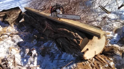

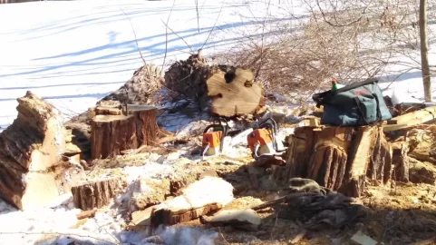

Here is a step-by-step of a locust beam I cut this weekend. On my commute to work I pass by this house with a big old locust tree on the corner of the property. A few months back the power company came through and chopped the top off it, as I guess it was growing too close to the lines. There was about 25' of trunk left looking all haggard, so I stopped and left a note one day asking if I could cut it down. Got a call a few days later and the homeowner said 'have at it."
Dropped the tree. It actually didn't want to go down, I think because there were no branches left to help pull it over. About 24" across at the base in a weird clover leaf shape.
It was a little tough to cut given the odd shape of tree, but took my best guess on how I might get a 8x8 section around the center. Guide is a 2x4 screwed to a 2x8 for stability, which is screwed to the tree. MS660 with 32" bar.

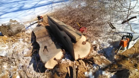

First face cut. Probably could have kept a bit more on the one side, but oh well.... it's for a wood shed so close enough is good enough.
I must have missed one pic in the sequence but I rolled the log so the cut face was on top, then cut the two sides. With the top being flat I can ditch the 2x8 and just screw the 2x4 to the log. One of these days I plan to buy a 16' piece of 5.5" wide PVC decking... wider board would be more stable and I think the jig would slide more easily on the plastic. I also need a peavey or cant hook to help with the log rolling.
Rolled it again and cut the last face. Final size 8x8x11'.

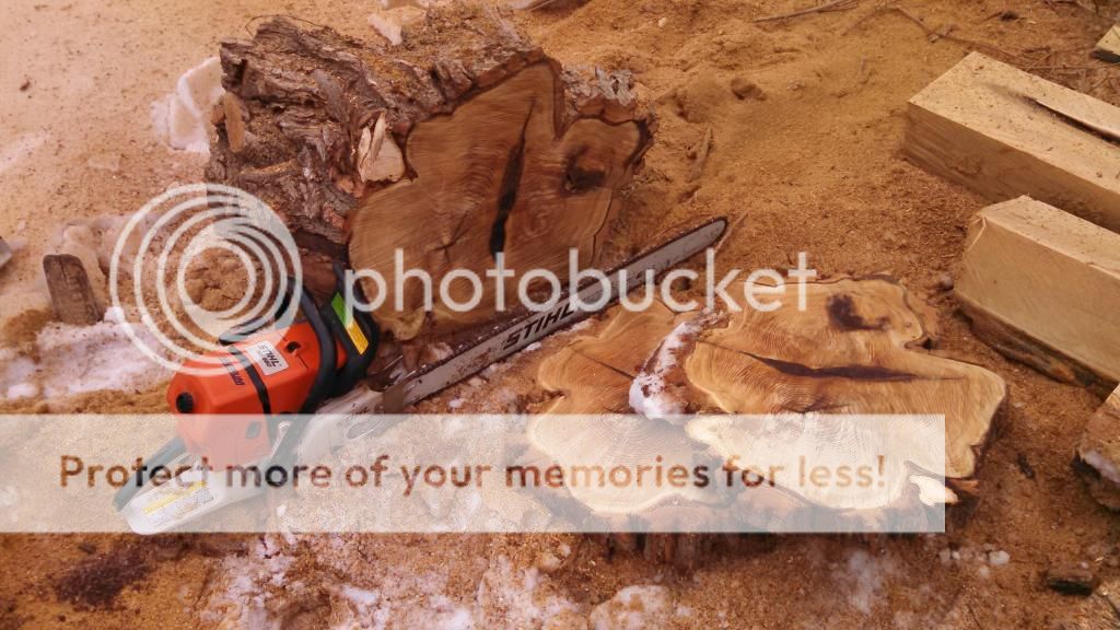

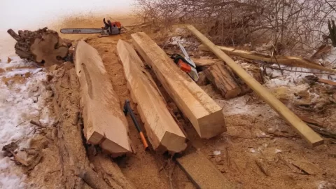

Cut one of the big slabs in half and plan to make a pair of benches out of it. The others were cut up into firewood. There was a huge crotch section at the top that I sliced into thick cookies and plan to use them as steps in a path across the back yard.

It looks to me like you have at least 4 pieces you could use to build a shed. The squared off piece in the middle is obvious but the one almost the same size with some bark still on it is darned near as strong in use and you could split that first large slab for 2 more good pieces. Lumber does not need to be square or rectangular.
Edfit: I see you already decided to split that large slab in half.

That looks awesome. Very nice job and great pics. I could see that working well for fence posts as well. Square certainly would be easier to attach panels to. I love that piece of wood for your stepping stones. Wish we had some nice straight trees like that up here. Everything left now is mostly softwood and really young. You post makes me really consider the jig. I just got to get a better chainsaw. I am still running my grandfathers Homelite - you know the old school kind that burns more oil than fuel and doesn't stop if you hit your leg.... :) Just might be time to upgrade, especially now that I have a wood furnace en route.

The pics are a bit deceiving... that last slab that came off looks to be about 6x8 on the end, but in the middle it's no more than an inch or two thick. You can see where it's just bark half way down towards the bottom. Just getting one 8x8 out of this was tough because the tree was so gnarled and uneven.
