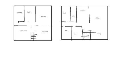

Ya the family room is about 12 x 22- and kinda opens up to the foyer but it's not totally opened, so i'm debating between 50,000 BTU's and the 61,000
How big is the house you're heating and where do you live?
Xxv probably won't heat the whole house. If you're just using it to supplement, though, you'll be all set. If you want to heat the whole house might want to look at p68. Same footprint as the 61 just a few inches taller.
the 68 is definitely too big. Putting the stove in the left hand top corner of the family room.
