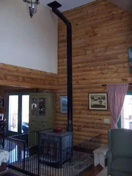

Hearthstone I (trying to post a picture)
  • [Hearth.com] Anyone ever burn a Hearthstone I? (Now with pics)

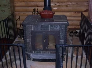

Trying another pic....

For $35 more I'd definitely go for the steel cat. The advantages over the ceramic cats are no thermal shock cracking and lower lite off temps.
Thanks Todd. I will take your advice and go with the steel. You've been a huge help.

I can see replacing my 6" single wall up to the ceiling. Photo above. It wouldn't be too hard or expensive. I think I'm stuck with the double and triple wall that is in the ceiling and through the roof. I assume it is 6" as well. I'll have to check it out next time I'm up there. Unless of course it is a safety issue.
Does everyone else agree with Rich's dealer that it is best to go 8" as far as possible if you are forced into a reducer?
Thanks in advance.
Scrounge

After reading more on this forum I was wondering about a flue damper with my setup. However I'm already concerned about the flue being too small. Would it make since to put a damper in one that is already undersized?
Since I was wrong about this stove being a Cat.or not and since it is a Cat. I'd get the Cat.installed and wait on the damper.The Cat maybe all you need.The damper calls for a very strong draft and since your undersized the draft may not be strong enough for the damper to work.I have an 8'' flue on my Blaze King and it's going into a 6'' at the ceiling then through the roof.My knowledgeable dealer said it can work however the 8" pipe should run from the stove all the way to the increaser or reducer which attaches to the pipe going through the roof.I did this and it works fine with a strong draft.
thanks for the advice Rich. I think I will go with the cat first and see how it works. Does the cat increase burn temps or just efficiency and burn times?
Would you agree that I need to find out what my max safe temp is before I get it much over 600 stove top temp? Or do I still have some leeway? I don't think I would want it much over that anyway just due to room temp comfort level.
It's good to hear that a professional told you the reduction is okay.
Thanks in advance.
Scrounge
Man Scrounge that's a good run of pipe.Ya,go on and put in the 8" pipe going into the 6" going through the roof.The draft will be much better and if you have any downdraft problems install the Vacu-Stack chimney cap.I did and now my draft roars like a freight train.Most manuals say that if your inside pipe can connect straight up with no bends that is the best draft.It looks as if your hearth could extended out furthur you could move the stove directly under the external pipe.Definitely more work however you should work just fine as is with the pipe change and the Cat.installed.Even just putting in the 8" should produced a better operation and even better when the Cat.is installed.If the Cat. doesn't arrive for some time will you be able to at least install the piping before the cold weather leaves? That way we can hear about the results.Well the best hook up is 8" all the way up and through the roof however the 8" to 6" reducer going into the 6" through the roof works well for me.
Isee u have the beast caged in. :bug:
ROYJ24 said:
My guess woudl be that is to keep small kiddies away from the stove, since the dogs would prolly figger it out for themselves.
Peace,
- Sequoia
I too like the stove cage. That's a nice hearth.
