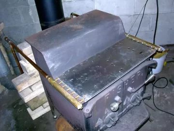

That said, I just finished up a wood stove water heater similar to the one in the link.
Some of the key features of my setup is, I used 3/8 OD ridged copper tubing sandwiched between two pieces of 3/8 aluminum with groves milled for the tubing for the HX.

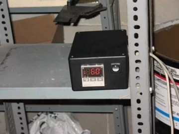

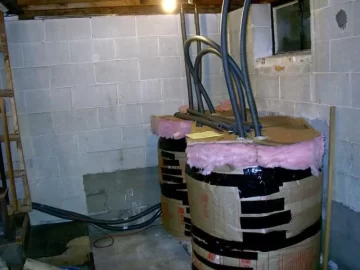

Also my set-up is non pressurized, there are 2 55 gal drums with a circulator pump controlled by a temp controller. A TC probe is inserted in the HX on the stove. I have a TP relief valve plumbed to the HX.

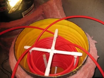

Cold water is heated as it flows through 4 100' coils of pex in parallel (2 in each barrel) and then flows to the input of the electric hot water heater.
I only have had the system running for 2 days but so far the hot water heater has not turned on yet. :-)
I plan to add 2 4' X 8' solar collectors in the future, I have one about half finished.
with 200' of 1/2 pex

WES999, so the stove heats the water in the drums, and the drums heat the water in the PEX?
Exactly, It is the same design that Gary used in his solar water heating system.
http://builditsolar.com/
The stove heats the water in the tanks and and DHW is heated as it flows through the pex.
The tanks are up to almost 150 °F right now.
The pex does a good job transferring heat, the temp exiting the tank is only a few degrees lower that the temp in the tank.
