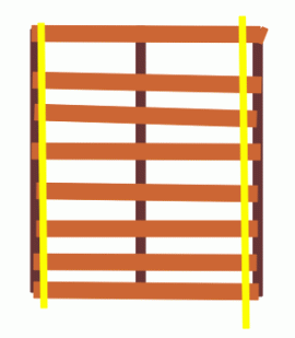

See the attached pic, sorry for the sloppy drawing. I cut through the slats as close to the rails as I can- on the yellow lines. Then you can rock the slats back and forth to work the slats loose from the center rail. Most pallet shops use rosin-coated air nails, so they are very hard to remove. You could even cut down both sides of the center rail if you wanted short pieces of slat without nails in it.

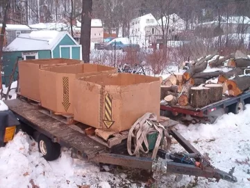

I've been cutting and burning pallets for years. Pallets are a great source of heat. As far as the "chemical" question...don't get your pallets from a chemical plant, paint factory etc. Chemically treated pallets are slowly being "phased out of the inventory" for ones that are "heat treated" easy to spot they are stamped as such (usually of 'block' construction also). 40% of all pallets in the US are used in the "Grocery/Wholesale" business the most common size is 42" x 40".
The easiest way to cut them I have found is by using a worm drive, carbide tipped circular saw On a "special table". Cheapest/best blades are (unfortunately) a B&D 3-pack for $13+change at Walmart.
Terminology: The "slat boards" are called "deck boards or just boards"...the "beams" are called "stringers" (notched or solid).
I find it is easiest to cut the outside top edge, then the top center...move to the other side and do the same. Flip it over and cut the stringers loose. I then cut the stringers twice with a 12" chopsaw...after I get a good pile of them.

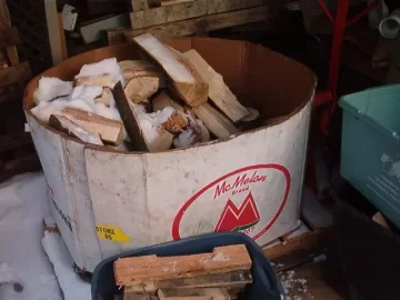

The "special table" is a "Euro block" pallet stripped down to it's basic frame...placed on top of a grocers' box commonly referred to as a 'gaylord' or 'watermellon box'...which itself is placed on a pallet. Always at a "comfortable working height". The one 'drawback' you might say is having to 'pull the pallet' from the stack to cut it...but all the pieces and sawdust end up in the box which makes up for handling the pallet...
If you can get your hands on these 'watermellon boxes' they come in handy. While maybe not everybodys' "cup of tea" whether they are filled with pallet wood or "cord wood" they hold enough wood to make it 'worthwhile' and still be easy enough to handle...the "less handling" the better.
