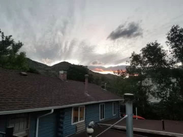

I have 3 radon mitigation systems on my property, all going to different places. We had one put in, but the basement was exposed dirt, so they basically put the system under a giant tarp, and tried to seal everything as best they could. This one vents through the foundation and outside. Fan is outside, and I can barely hear a hum running through the system if there is NO noise what so ever. Numbers dropped significantly when the system was installed.
The second is going under the concrete slab in our living room, which is not the same as where the crawl space was. Fortunately we had to tear out the gas wall heater unit, and had a perfect little space to run the pipe, and an outlet nearby. Popped out the roof where the old vent pipe was, and called it good. If I am in the closet that it is in, I can hear it. When it was installed, the pipe just went about 1', then the fan, then 3' of pipe and a 90º bend. After we put on the deck, and replaced a window, we decided we didn't really want radon blowing right at us, so I extended it.
