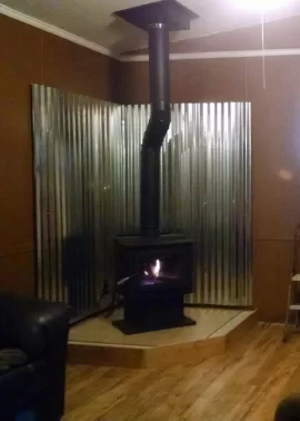

I have 15ft from stove top to chimney cap. It goes out of the stove 2' then a 45° with 1ft to miss a rafter then another 45° then up another 2 ft to ceiling box then duravent class A triple wall the rest of the way. It clears the peak and anything around it by 5 ft.. It drafts well have never had smoke come into the house. But I have noticed it does seem to do better when its colder outside. Tried putting a pic but said it was to big to upload
Here's one picture

That looks like it should provide adequate draft for your stove. Like moresnow says, some smaller splits might help especially if you have only big ones in your stacks now. Big splits gas slower, especially if the wood isn't real dry. I use a lot of medium or smaller splits, 5" or less. But I have a cat stove so it's easy to cut the air low to control the burn rate. Once you have dry wood, medium and big splits will help you extend burn times with your tube stove.
Most of my splits are 3-5 inches but I've been splitting them down to more so 2-3
