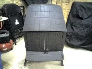

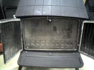

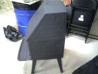

I received this stove recently with no information.
Does anyone recognize this unit or know anything about it? It was well rusted with old hardware, I wire-brushed it and repainted it.
Just curious...if anyone has seen one.
Thanks,
Tuddy

yes, i've seen one, i believe it's an old danish stove, perhaps jotul.
Any pros or cons that you know of? Planning on heating a 625 sqf. insulated garage.

Craig, impressive ID :)
It's just for a detached garage, no tags of any sort anywhere. Should I beware?
Thanks for the info everyone! Stay tuned....I'm now going to consult my ins. agent.
Thanks again,
Tuddy

BTW, the Morso 1125 was a great stove - that thing really cranked out and was very efficient. That design with a large radiant surface in front like that....it really kicks out the jams.
The original was popular in matte black or green enamel.
Great! Hopefully my ins. agant gives me the green light, or....it will become my favorite boat anchor!
