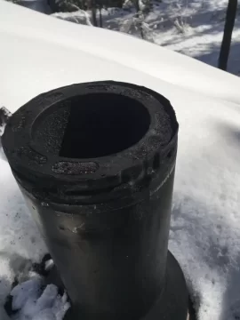

Anyone recognize this type of chimney?

I need to add 3-4 feet of this type of chimney. Never seen it before. Is 6” ID. Similar but different than duraplus. Pls help

Measure the outer diameter. I believe that metal fab is 9" diameter for a 6" inner. They claim a 1.5" clearance to combustibles, but the pipe is larger.
