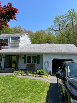

Trying to improve draft on my Jotul wood insert. . Guessing that the split level nature of house doesn’t help draft. Looks like chimney would have to be raised about 6 feet to be level with other roof. Do you think getting it higher than other roof is needed or would just raising a few feet likely help a good bit? Trying to not add any more height than needed for aesthetic and finances.

Extending should help. Maybe try adding a temporary 3 or 4' section of 6" warm air duct to the liner to see how much.

Lots of people have this install in CT. In theory, extending the chimney should help, but will not help symmetry with how chimney looks in comparison to the house. My situation I found was my stove ran a little better when extending my chimney about 2 feet (my raised ranch chimney is on end of house) and the liner inside it, but my best solution was getting a stove that was an easy breather (I went from an Oslo F500 which I loved, great heater pretty enamel color stove, long pieces of wood...) Enviro steel stove. The Enviro just wasn't as finicky about draft with temp differences. My prior stove (Quad 3100 FS steel stove was easy to run too) The Oslo below 35 degrees was much easier burning than at 45-50 degrees. The Enviro would burn fine at 70 degrees if I wanted to. Also installing many stove brands and burning them, the PNW stoves (Pacific North West) just typically drafted easier and were easy to run. Brands like PE, Enviro, Quadrafire, Lopi and Napoleon I found were easy to run, great heaters. Its the steel frame vs cast iron thing, steel heats up quicker than cast, but the cast is more aesthetic pleasing to most) I guess we all adapt to what is required for it to work. The Rockland is a nice insert, very decorative, but you can see the chimney is fairly short, Jotul would tell you they want a minimum 14-15 feet of chimney.

Thanks for the input. I think adding 3 feet should bring me up to about 16 feet, so hopefully that works. Reason I ask about the the split level nature of house is because I thought I read at some point that the draft on the lower end if that’s where the chimneys can be impacted. I wanted to ask that upfront to see if anyone on the forum thought that the positioning of the chimney in general would likely be bad, unless it was extended something crazy like 10+ feet or something. I think what I will do is add the few feet of cheap vent as a test, as mentioned above, and see how that impacts the draft.
I hear you on the symmetry issue. I’m guessing that adding 3 feet might look OK, but more than that would look a little strange. Fingers crossed, I suppose.

It's a valid concern and may be one of multiple factors. Stovelark is right, the C550 is designed for a 15' minimum flue height. There are others that work well on shorter flues if that's the best solution. This is why l like rigging a temporary test setup before committing big bucks on a strong visual change. Hopefully the results with a 3' stub added will make a nice improvement and the Jotul can stay, but if it still is unable to support a robust secondary burn, then a different insert may be a better solution.

I will definitely do the 3 foot stub as a test, but that will have to wait for fall time at this point. Thanks again everyone for the help.

Air sealing the upper floor on the left will help keep it from acting like a better chimney than your chimney.

there are draft booster caps also ( electric fan), can't tell how well they work never had one. then there is the 10-3 rule flue should be 3 ft over anything within 10 feet of flue termination. Draft can also be comprised by external forces. Like being halfway down a hill or big trees close by ect.
Interestingly, my house is down a hill a bit. Not a massive hill with elevation or anything, but the slope from the street going down towards the house has always been a bit annoying for a bunch of reasons. And also interesting, we do have a fairly large red maple to the right of the house. The branches of that tree are probably at least 25 feet away, so I’m guessing and hoping that that’s not part of it.
