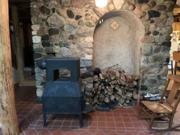

Thanks for all your input and time @begreen - this is a big change after 41 years and a lot new technology to lear n- cat/no cat/ standing pipe liner/Flexible/ remove clay liner/ run flex down liner and what stove? Yikes Here is our set up in pic below.
Situation - Beneath the stone are 3 chimneys and the wood bin2 - block chimneys together on Left (facing), bin, then another unused block chimney with clay liner used for maybe half a year on Right - we had a lovely old Kalamazoo wood kitchen stove with the copper water bin and warming ovens - it was sweet. The leftmost chimney has dry-staked clay liner I know has cracks and who knows condition of block - we clean 1-2 X year only and have creosote smell when its damp - no rain cap(!) - the other 2 have rain caps - not sure why... We burn 8 mos/year - windy lake effect by Great Lakes region - In winter we burn constant and go through that full wood bin in a week.

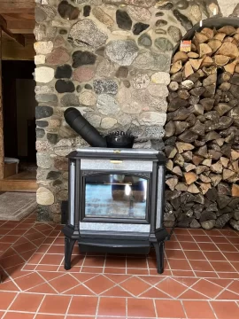

People seem to love or hate soapstone, but my stove comes in both left and right hand door configurations (Hearthstone Heritage 8024):

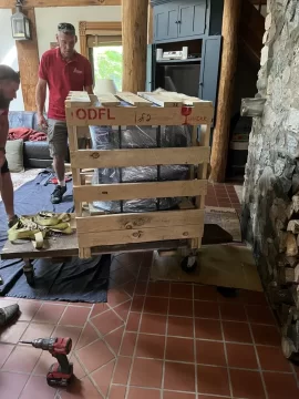

Update on Jotul 121 replacement: Very long winter with no stove. Progress Hybrid finally here and indtalled today, a very hot day in June. Everything about this acquisition has been a pricey challenge - 812# nmy friends - figuring out getting it here was not easy - shipped to the closest loading dock, hi lo put it on our trailer on a heavy duty low dolly tied in place. Ramps from trailer to sidewalk to front stoop, over 2 thresholds , then 4 bug guys and 4 house jacks to get it out of crate and in place - some clever engineering. So, here is the beast, ready to roll.
[Hearth.com] anyone still making Right Side load stoves?[Hearth.com] anyone still making Right Side load stoves?
Looking good!
