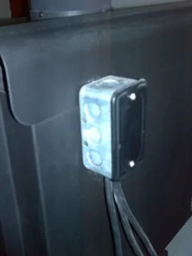

If it seems to work for your setup, and wanted to have it come on automatically when the stove is warm, you ca install a Therm-o-disc switch like this:
  • [Hearth.com] Anyone use forced air unit to circulate heat from stove
