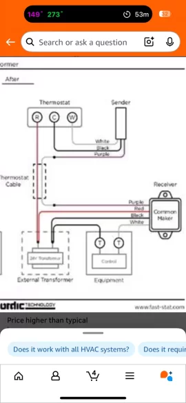

Remember these are 24v AC systems. Think common as hot and then you need to make the neutral connection back to the transformer.

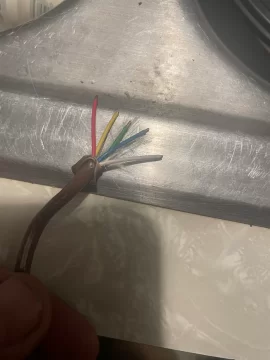

Thermostat wire is all color coded. Your baseboard isn’t asking for specific wire colors? While electricity doesn’t care about the color, the next guy who works on it will thank you if you keep it standardized!
I had a HVAC guy suggest/warn me to use the 18g vs 20g wire. It probably saves frustration.
Thanks. I have that same diagram. On the transformer end, the purple from the C Maker to the white thermostat. The red from C Maker to the red from thermostat and to the transformer.
Here's where I'm not sure about. The white and black from the common maker go to the TT Control. The 24V transformer is inside a small metal box. After I cut the power and open that box, it looks like the red and white wires both go to the transformer. I will open it back up in the morning and re-check the wiring inside and double check what is connected to what.
[Hearth.com] Anyone with HVAC or Knowledge Regarding Installing a Common Maker?
from the common maker the red goes to the red on the transformer which runs to the thermostat. The black wire on the common maker connects to the other red lead from the transformer. The White lead connects to the white wire from the side of the contactor and then the purple connects to the white wire to the thermostat.
I'm good on connecting the sender to the thermostat.
Ok, I think I've got it now.
Well, thank you all very much for your assistance.
I borrowed the image from @EbS-P post above and thanks for that as well.
I won't get a chance to work on this until Monday so I will update then.
