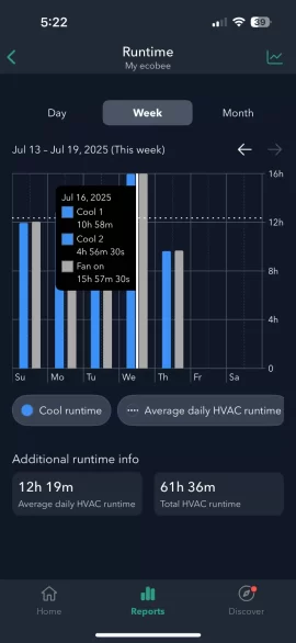

Just from a data perspective ecobee is doing a much better job showing data on the phone app than a year ago. I guess you have to be ok with sharing your data with them. I wish you could enter a model number and it would calculate kWh usage. I have not opened the web interface in a year.

If you can measure the amperage in stage 1 and stage 2, you can multiply that by 240V to get Watts and then use the run time to get kWh.
Ecobee is a great way to get run time data, but the math is easier for single stage systems. A variable speed compressor would be even harder to calculate without something like an emporia vue energy monitor.

Yes I know I run 1.8-1.9 kw in stage 1 and like 2.8-2.9 kw in stage 2. (From the manual. And verified by my Tesla app within 200w).
At the end of the day it’s neat data but doesn’t help me save any money;)
