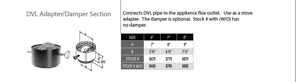

I bought some Simpson double wall stove pipe pieces and purchased the DVL adapter which the Simpson manual says can be used as a stove adapter. The pipes came in yesterday and they mis-shipped the adapter and gave me one with a damper(no biggie since they didn't charge me). The problem I have is the DVL adapter has a very poor fit to the flue collar. The stoves flue collar has a 6" ID and 6 5/8 OD, the DVL adapter has a 5 5/8" ID and 7" OD. I guess I should have measured before ordering! :lol:
Does anyone know if a DVL adapter is required for the Endeavor when using the Simpson DVL Pipe? It was 12 last night when I was messing with it so I didn't check to see how the pipe by itself would fit to the flue collar, I plan to check that tonight with a clear head and fresh eyes.
Also do I need another adapter to connect the DVL stove pipe to the flex liner tee snout? I waiting for the liner so I don't have it to check it against at this point.
Picture of the DVL adapter attached for reference....

I hate that adapter. I'm trying to get rid of mine now. Not sure if it fits your Lopi but it won't fit the hearthstone heritage.

It does not appear to fit my Lopi, I hate it also! :lol: I ordered it without the damper so I'll be returning this one.

I downloaded the PDF already, the inside on the DVL is 6 and the collar is 6 so they're a near match. I think I could get it down on it but haven't forced it yet. It just looks unfinished to me that way, I'm figuring there has to be a better way. I think I'll call the stove shop and bother them, I'm sure they'll have the answers right off the bat.
