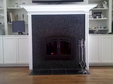

I looked at these models several months back when I was trying to decide which to install in my home as well. From what I could tell, they are the same. 2.0 cubic ft firebox and 19" log capacity, 55,000 BTU output, etc. Lennox was more expensive, though. I ultimately decided to go with the FPX 36 Elite and so far, I have been very happy with the fireplace. A lot depends on how you will use the unit and exactly what you are trying to achieve. Here's a pic of the FPX that we installed.
