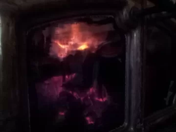

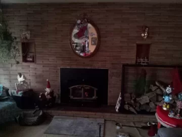

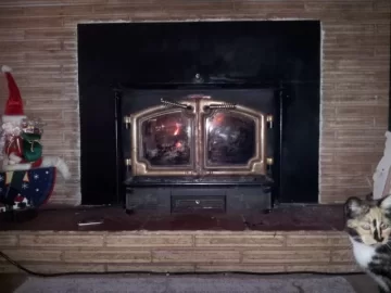

Old lopi fL model. I thought it was small compared to my older blaze king insert downstairs, but even this thing seems like today's large size insert. It's got to be at least 3 cubic foot firebox, but can't find specs to be sure.

looking at your pics it looks bigger than 24, looks more like 32+. Looks like panels around the insert
The one downstairs is 26, so I'm assuming this one is the same. It's sealed into place, so I can't move it until it's time to clean the chimney next year. They're more of a rectangle shape. The shroud barely fits from side to side, like 37 or 38 inches wide.

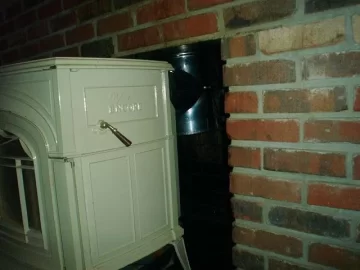

Here is a pic of my stove that is lower than the 28 inch masonry opening. I have a older Vermont Castings Encore that was biggest they made. The flue connector can be reversed for out back or top.
[Hearth.com] Are there any new "hybrid" inserts that stick out instead of flush?
Looks nice. I don't think it would work for mine though, since your's looks to be about an inch or two from the 28 inch top masonry opening. So, 25 or 26 inches minimum opening I'm guessing, and I'm maxed out at 26. Would be a tight squeeze just for the pipe. Maybe I could ditch the legs?

Is the IR connected to a straight up chimney?
