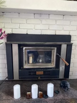

Arrow Wood burning Fireplace insert. HELP!
empireman
Nov 11, 2020
1
Hollywood CA
He - We have an arrow insert purchased a few years ago but never connected. I replaced a bay front insert that came out too far from the fireplace and as you can see - this one is flat. The 6" liner is still in the fireplace and I thought it a no brainer to hook this one up when the time was ready. The problem is that the new (used) insert has an oval chimney pipe connector and I can't find an adaptor to go from that to a 6" round flex chimney pipe. Anyone know where I can find the connector? Thanks in advance!
[Hearth.com] Arrow Wood burning Fireplace insert.  HELP!
Not all oval flue collars are the same, so the Oval-to-Round adaptors available at stove shops may not be compatible.
You may need to make a template & take it to a reputable welder to have on fabricated.
If you do, stainless steel is the best material to use...
