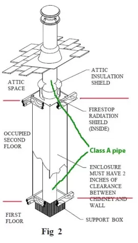

There would need to be a ceiling support box at the basement level and a firestop as it passes through the 1st floor ceiling to the attic, with an attic insulation shield on top of the firestop. The chimney will need to be boxed in a chase with 2" clearances as it passes through the first floor. Something like this.

Thanks again begreen. I could do this easily, if I remove the transite pipe. I'm still curious about why I cannot use a double-walled liner inside a sealed cement/asbestos pipe that has several inches of space between it and combustibles (except where it ends in the basement as can be seen in the photo above).
As I understand it, using a large asbestos/concrete pipe... it just hasn't been done, and hasn't been tested, so isn't possible, despite it being possibly safe and effective, and in my case convenient.
Yes it may be safe we just dont know. Are you willing to bet your house on it? You say it has several inches of space around it yet in the pic you posted there is wood touching it. What is supporting it if there is space all around it?
