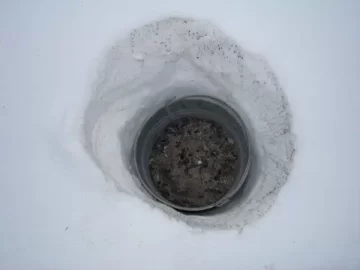

Sitting the bucket on the snow ain't all it's cracked up to be either.
Thanks for posting that great shot again. It's a classic.
