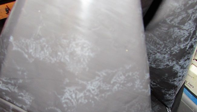

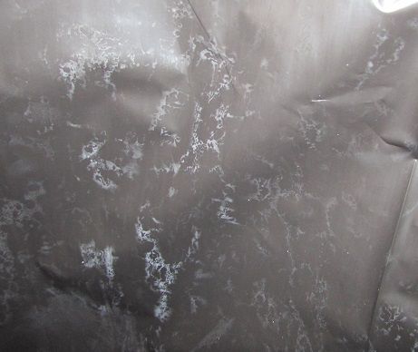

I have a Shop Vac ash vacuum. I laid out some black trash bags to detect the ash residue earlier. Here's the pics I just took.

Static from the plastic will attract the smallest of particulates. Can you run the combustion blower when you clean the unit? Pellet dust occurs even with vacuuming... Some forum members have fitted filters on the convection blower but it wouldn't capture that small of particles.
My father had nasty allergies so they had installed an electrostatic precipitator to the furnace/air conditioner they had. May have to look at some kind of air purification unit.
No, the unit has to be shut down while cleaning, and it will not run with the door open.

Get a hepa filter for your shop vac. The standard paper filter is not fine enough thus allowing fine ash particulate to blast through the house every time you clean.
The Shop Vac ash vacuum I have has a HEPA rated filter.
Thats a good start. Some members here have recommended putting a wet rag over the exhaust port of the shop vac to capture any other little stuff that may be to small to be filtered.
Depending on where your stove it located you could try buying another hose and putting it into the exhaust port and directing the outlet air out a window.
Personally i am thinking about ducting the exhaust port of my vacuum outside using central vac pipe, essentially turning my shop vac into a mini central vac unit
I don't think it's my ash vacuum. I'm going to check the gasket on the exhaust blower to see if it's leaking.
