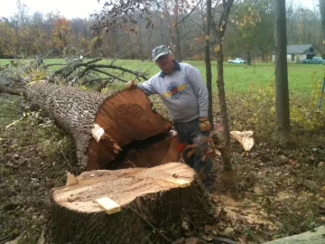

Find a big ash (over 40" DBH), make a face cut, and walk away for 20 - 30 minutes. When you come back, you will see.
The tree below was one of these cases. It was forked too high to cut the two trunks individually, so I made the face cut below where they joined. It became obvious it was going to come apart during the back cut (you can see the crack thru the trunk, perpendicular to my hinge), so I took a break to arrange a strap between the trunks, to help ensure that it wouldn't prematurely come apart on me.
During the 20 - 30 minutes it took me to arrange the strap, it started gushing. Thought it was the strangest thing, until I had a second one do the same thing to me, a year later. Both trees were large (over 40" diameter), and both seemingly dying of something other than EAB, as this was before EAB was known to our area.

That's a big ash!

That property has a lot of big trees, and it's where I did nearly all of my cutting for 10 years. The guy in the photo is my old cutting partner and property owner, recently deceased, and I use to leave him all the smaller stuff that was easier to lift. That meant I was dragging home all of that 4-foot crap.
Big wood is fun to drop, and fun to look at in photos, but hell to move the rounds and split. ;lol
