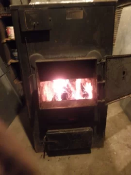

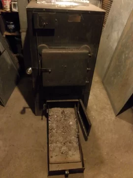

I love my ash pan in my old Norther Leader furnace (PRE EPA) Some of the newer stoves I have looked at the ash pan appears so small.
[Hearth.com] Ash Pans: Yea or Nay[Hearth.com] Ash Pans: Yea or Nay
Before the safety police jump in and mention the paint in the background it is latex. I do not keep any flammables in the furnace room. :)
