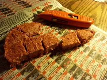

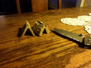

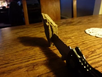

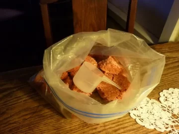

what is a ‘cat’?....this looks like homemade firestarter, what is it?
Sorry, 'cat' is a catalytic combustor, but your stove achieves the re-burn of the smoke with secondary air.
The orange hockey puck starter that I chopped up is the SuperCedar..cedar chips and paraffin wax. Yes, some folks have made their own..
