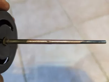

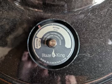

Hi all, haven't been around here much lately but figured I better check in with the experts on this topic.
My Ashford 30.2 was installed in December 2018. I estimate I have around 17,000 hours on it and I'm starting to notice symptoms of combustor failure, such as visible smoke during a burn and reduced burn times. The attached pics show about 2 hours into a recent burn.
This stove has always been really consistent. Typically when temps are in the 30's daytime and 20's nighttime I can get 20+hour burns but lately I am down around 16 hours. I also had a load stall with a couple partial splits left, which has never happened before. It just doesn't seem as consistent or efficient. The combustor barely stays active for some loads (at the first white tick mark), while it runs up around 11-12 O'clock for others. FWIW I am burning Fir that was CSS in April/May of 2021, typically under 14% or so.
So I've been shopping for a replacement to keep on hand and probably swap this summer. I've been interested in a ceramic based on some past threads here, and I have had plugging issues when occasionally burning Aspen. I also run a 12' stack and it seems the ceramic might flow better, although Midwest disputes this. I did some searching on this forum and found older threads from @Ashful running a prototype ceramic combustor. Are these new ceramics now available? Or do I buy one of these through Midwest? I can also be talked into another steel if it's really the best route to go.
I also attached a pic of my combustor probe - is it time to replace it based on wear or is it just getting broke in?

That cat meter probe looks great. Check calibration when cold per the manual.
