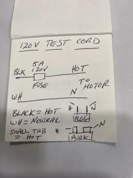

One other thing you could do would be to test all motors and igniter with a test cord.
