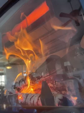

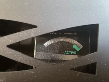

Thank you all for taking the time to reply. I have basically started ignoring the temperature gauge and have been engaging the cat whenever the fire gets established. Included are the pics of my current burn. As you can see the fire is going strong with a red hot cat but the temp gauge still is not in the green.

I think your gauge is faulty. I'd contact the dealer or mfg for a replacement.

But while it looks ok, please do look at the chimney 10 mins after (preferably) the stove air has been turned down (so not a lot of flames) and the cat glows.

The fire and cat look good. Yes, call the dealer. The gauge may be ok if the probe fell out of place. Regardless, it needs to be fixed.
