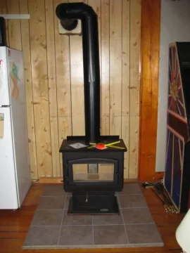

I just purchased a Drolet Savannah wood stove and it came all assembled except for the handle. The instructions tell me how to attached everything but the handle. Maybe I'm not strong enough :coolgrin:. I did a search on handle and in the first 6 or 7 pages didn't see what I was looking for. There's got to be some sort of trick to this (and I have to wonder why they didn't put the handle on in the store when they did everything else.
I've pushed, twisted, pried at it to try to open it, tapped at it with a hammer, it just won't get on. I'm beginning to wonder if it's wound too tight and that's why the store didn't have it on.

You can see the handle sitting on top of the wood stove. i wrote the company and they said it should go on by rotating counter clockwise but that didn't work so i asked some one stronger than I to try and he couldn't get it on either. I think I have a defective handle, am going to bring it into the store and ask for a replacement.

LOOKS LIKE TWO HANDLES ONE ON THE DAMPNER DID YOU TRY SWITCHING THEM?
Some of them can be a bear. I have never had one of the "impossible" ones not succumb to holding it with the end that goes on the rod facing you and twisting the living crap out of it with a pair of Vice Grips locked on the end of the wire turning away from the direction of the spring tension.
Failing that working, lock said Vice Grips on that same end of the wire and bend it out a little from the rest of the spring. It'll screw on the rod then.
