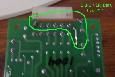

have you checked the connection at the control board? You have done everything i would have done. I'm leaning towards a new control box. gotta use a good surge protector. these guys here all preach it and i learned it the hard way! somebody more knowledgeable than myself should pipe in and help more
Lighting hit my utility pole this summer [Hearth.com] Auger Motor will not turn on

Hey Ssyko - picked up a new control box last night... fixed my issue. back up and running now. I also have it connected to a surge protector -- spendy lesson learned.
