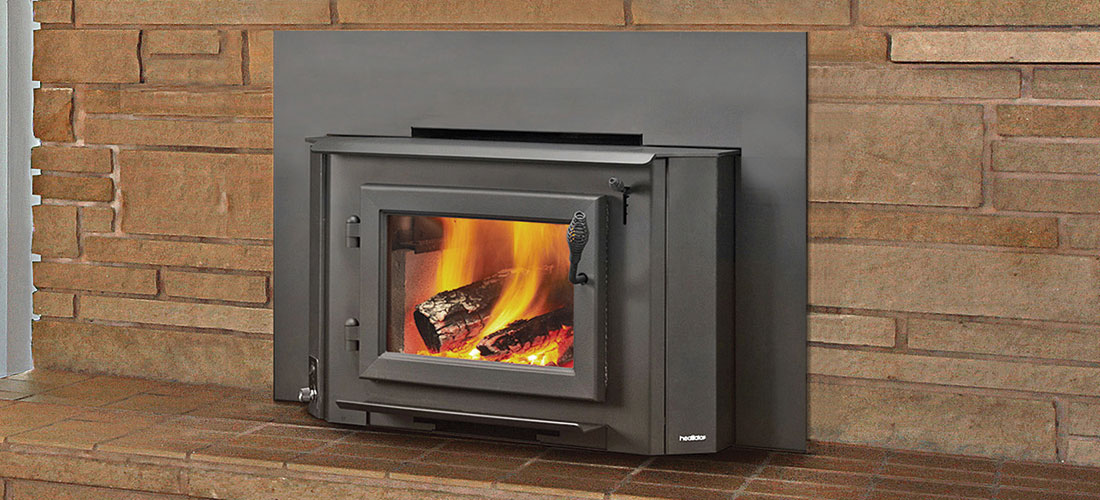

I considered the wins18 and it looks well specced. But wife vetoed. I won’t rule it out though.
The ADF linea is looking like the best option. But their lame warranty gives me pause for thought.
Mate has the freestanding ecomaxx. It's not bad. Sheet metal door doesn't impress me but that's just preference.
Wins18 is better quality. I have its bigger freestanding brother and am totally impressed.

Would you take the wins18 over a tn20? I can always argue for an ugly duckling.
Yes, agreed. I watched the same video. Might be the least worth option though and I could modify it. I will ask the distributor if the “german made fan” is brushless. That warranty is a problem though.
From what I can see the Ecomaxx seems to be locally owned, made in Canada, few sold, at risk of being unable to get parts in the future.
You might be right about the Ecomaxx.
I would absolutely take the WINS over the True North. The efficiency of the WINS is quite a bit higher than the TN20 and emits fewer particulates. The warranty is better. The steel is thicker (although this may not actually matter). I haven't checked but I'm sure the prices are comparable.
I have had great experience with Pacific Energy's (and Pivot's) customer service and warranty though. No experience so far with the Heatilator/quadrafire warranty.
They are both ugly, but sometimes form has to follow function (wives often don't agree).

Confirming that the ADF fan is brushless. The firebricks are Vermiculite, as is the baffle. That handle will drive me nuts and their warranty that excludes "Glass, Refractory Firebricks, Door seal, Glass, Flame Grate, Paint", gives 2Y on electrics, only 5Y on the "equipment structure" has swayed me to the WINS18. Lobbying my wife...
