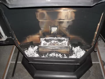

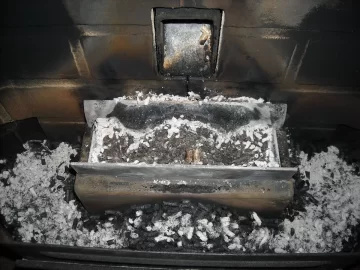

    Trying to determine exact cause and effect of a dirty burn!

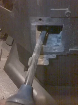

    Last few early mornings on low # 2 heat level the glass and firebrick went black wit black unburned pellets in the pot and grayish ash. Real sign of not enough air to burn. stove was mostly clean so not anything that could easily be seen. I had some time tonight, so after cleaning, I removed both outside ash chamber covers and noticed that the horizontal chamber running behind the fire chamber down low was completely clogged with ash. So when looking at the front of the stove, the air on the right side of the fire box going up across the right 4 heat eschanger tubes running down the right ash chamber was trapped and could not continue to the exhaust blower. The left side still had a path but was restricted quite alot, almost all clogged up too! So I removed the outside traps and cleaned really well all the ash blocking this path.
    Will this due the trick. see pics below:

    Well it happened again, A real dirty burn on a very damp night. The stove is clean! So I finally figured out what else can cause this problem! The stove is on it's 4th season and the combustion blower is failing! The older Combustion Fan was not maintaining it's lower speeds on the lower heat settings! My friend has a Breckwell P24I with the exact same problem. He also noticed there was no fly ash on startup. His stove like mine was also clean as a whistle inside and out. we replaced the combustion blower and bingo. The fly ash is back on startup!
