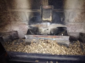

[Hearth.com] Avalon Astoria troubles I have an Avalon Astoria FS pellet stove and am having a tough time keeping it burning correctly. Yesterday I did what I considered a thorough cleaning. I cleaned the fire pot, removed the firebrick and cleaned the refractory, cleaned out the exhaust ports, removed the combustion blower and cleaned, removed the exhaust vent out side if house and vacumed all fly ash or soot from all areas cleaned. I also removed the flexible inlet to check for debris, there was none. I fired up the unit after putting it back together. I set the unit on low-med and had the restrictor set on 2. The unit had a decent flame after about 20 minutes but as time went on the flame began getting smaller and I noticed some pellets were blowing right over the fire pot, I adjusted the restrictor to about 1 1/2 and the flame picked up to an ok flame. With that I had other chores to do and I figured let it run for a while and check back. The attached photo is the way I found the stove. Any help or advice is appreciated.
When cleaning exhaust ports are you using a dryer lint brush or at least a wire and a hose attached to shop vac? (stove completely cool and use drywall bag) The area on the back wall would also become clogged with fly ash too - if you are not trying to clean back there it will get clogged. Probably time to try the Leaf Blower Trick (search the forum). Make sure ash trap doors are closed properly when done.
The other thing to check would be the dollar bill test on your door to see how well it is sealing...

I have found that some pellet brands are faster/slower burning and need more or less air. The real test for your burn rate is how the flame looked. Do you have an active flame with a few sparks jumping out (like pictured in the manual)? If not, open the slider more. Sometimes I start mine on wide open (5+) then dial it back to get the flame right pushing it in 1 every 10 minutes or so.

oh, take off that rubber tube on the back and clean it out. Also, clean out the thimble to the exhaust blower with a pipe cleaner. A dirty one of those can contribute to the issue you are describing. Make sure you do this unplugged because there are live wires back there (ask me how i know).
