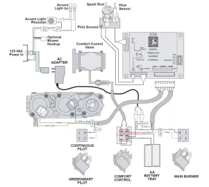

I have a 3-4 years old Avalon Eden that suddenly stops working. This is the version with remote and I think it has no thermopile (according to manual and schematic). It has “digital fireplace control” module, see schematic attached. The pilot flame is fine, but main burner does not light up when heat is called via thermostat or manual. What can I do to trouble shoot this?

Hello, yes I have tried all that, none work. I think the logic board is working correctly, receiver beeps at appropriate function, relay(s) clicking on appropriate command, I can hear stepper motor running to control flame height when commanded (via remote) even when there is no main flame. I am thinking it's either the main gas valve stuck or bad pilot sensor.
