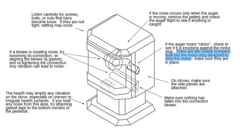

I found a service manual for the stove and it has steps on removing auger cover for inspecting / vacuum it out, requires applying high heat silicone to seal it when replacing cover which doesn't sound to difficult.
It also mentions the symptom I'm having and says the motor stop should have 2 rubber bumpers installed to prevent this clunk sound but I'm not seeing anything other than bare metal, where could the bumpers have gone? lol (maybe a revised part over the years?)
They sell the motor stop separately maybe I just need to order a new one.
