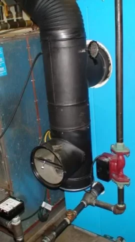

One way is to tee off the back of your boiler and install about 2' of flue pipe and a another tee close to the floor , with your damper and clean out plug . This way you only suck out cool floor air and no back puffs from the wood boiler.
Anthony
  • [Hearth.com] avoiding/ minimizing barometric damper/ draft regulator parasitic losses
Thanks Anthony- only thing is, I am mainly aiming to try to prevent having household air goe up the flue at all, except when absolutely needed (during an actual burn)- because whatever air goes up the chimney has to be replaced by outdoor air that will leak in elsewhere.
