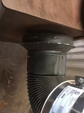

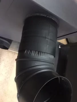

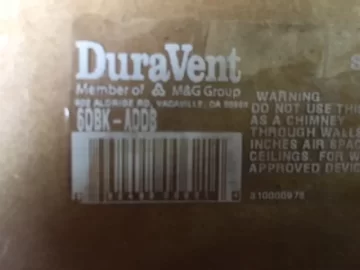

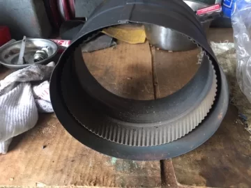

Attached are some pictures of the adapter and elbow in the back of a Baby Bear.
[Hearth.com] Baby Bear Pipe
Adapter and elbow (Loosely fitted)
Inside the adapter. Close end goes into the stove.
Label on Duravent Adapter box.

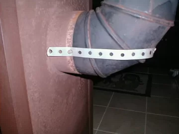

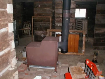

That is the same part shown in Don's center picture above. The inner pipe in that adapter should fit inside your outlet. The side of a single wall Tee should fit OVER your stove outlet, just like the female side of your elbow should fit over it. Your stove outlet should measure 6 inches OD. The inside will vary due to wall thickness requiring more of a crimp on a factory male end, or the use of an adapter. It doesn't cost anything to crimp the end down to fit, I guess some people just don't have the right tool to crimp it down far enough. The adapter makes a better fit.
[Hearth.com] Baby Bear Pipe I use pipe strap for support when crimping.
[Hearth.com] Baby Bear Pipe Same stove with Tee OVER the outlet pipe.
