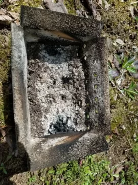

The issue is that ash keeps building up in the pot. I can burn one bag of pellets and then the ash will need to be emptied from the pot. There are some klinkers, but also a lot of fine ash and partially burned pellets. There will be almost nothing in the ash pan.

Having owned a Baby for over 10 years, Don's advice is spot on. A pellet stove needs airflow to work. The Baby has a unique design that, in theory, pulls air through the burn pot which should make the ash fly out and eventually end up in the ash pan. If the air flow is not strong enough the ash stays in the pot causing buildups and clinkers. Once the horseshoe is cleaned you will see a huge increase in efficiency.
I did the modification on mine the second year I owned it. I welded up three rows of holes on the burn pot (at the top). I also replaced the combustion blower with the high altitude fan. These mods allowed the stove to run on average 4 or 5 days before I had to empty the pot. With a light demand I had gone a week between pot dumps.

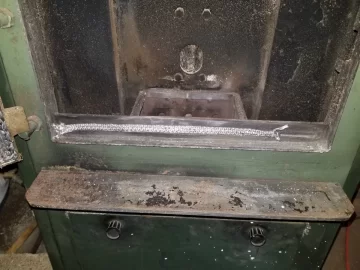

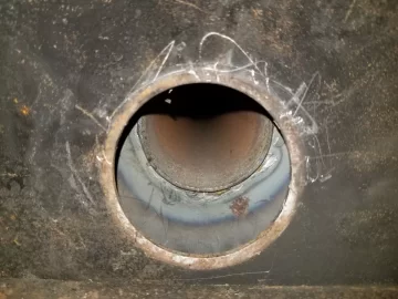

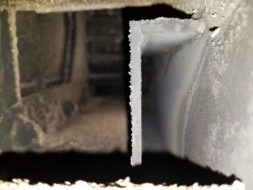

I did the horseshoe modification and some ash came out when I hit it with the air compressor, but not much. When I burn it, the ash is still staying in the pot.
My guess would be there is still some ash blocking the path through the stove. if it spent a few years of its life in a garage the ash will absorb moisture through the seasons and turn hard as a rock, especially if it was never cleaned before its retirement. You may have to remove the exhaust blower from the stove and take some stiff wire or coat hanger to break it up.
Reactions: johneh
Do you have the upgraded 3 wire 105 CFM exhaust blower that helps your issue?

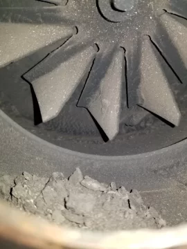

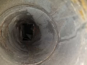

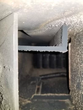

I purchased a new air compressor attachment that has tubes that will go into the horseshoe modification hole and blew it out with the compressor again. I checked the exhaust blower, all the passages, and the direct vent pipe and found nothing unexpected. I did find a piece of gasket that seemed to be plugging up what could be a glass air wash. I removed it and the performance was much worse.
I did not remove the blower since it seemed to have some kind of orange caulk that would probably need to be replaced. I don't have the upgraded 3 wire blower, where can I get that?
In other news, the auger stopped moving last night. I removed the pellets from the hopper and removed the stuck pellet, but the auger doesn't move. The motor makes it's usual sound, and the auger moves back and forth if you manually move the motor, but the motor will not drive the auger anymore. Kind of sounds like a stripped gear. Is this a common issue, and is there a repair kit?
I have attached some pictures that I took during the latest round of cleaning.
