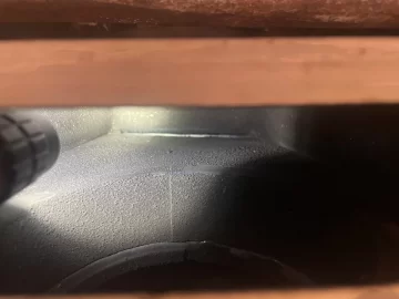

Did you post a picture in another thread? My guess and it’s just that, your overdraft got the offset too hot it failed and is now leaking sucking cold air up the chimney and reducing draft in the stove. My recommendation is to see if you can use angled appliance adapters and a damper and get rid of the box.
Post a picture of you can. Also you can leak test the the box to see if it’s sucking smoke or flame from a candle into a joint or seam.

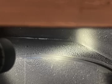

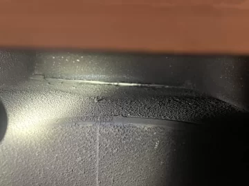

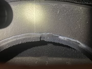

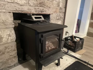

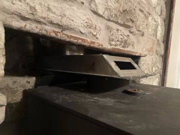

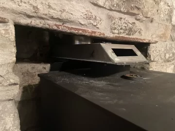

Thank you for the replies and input, I think you’ve probably nailed it. I think my wife had gotten the stove too hot while I was at work, and this caused the box to fail. I took off the clean out plate and the box is split in the back as well. I’ve posted some pics, I’m assuming that’s the start of creosote build up as well in the offset box?
